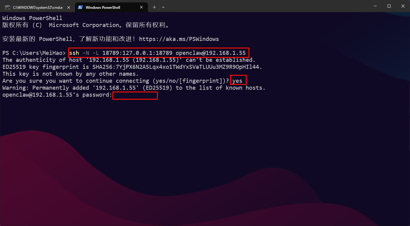

- 远程配置:通过Windows浏览器远程访问,需要配置SSH隧道和网关令牌

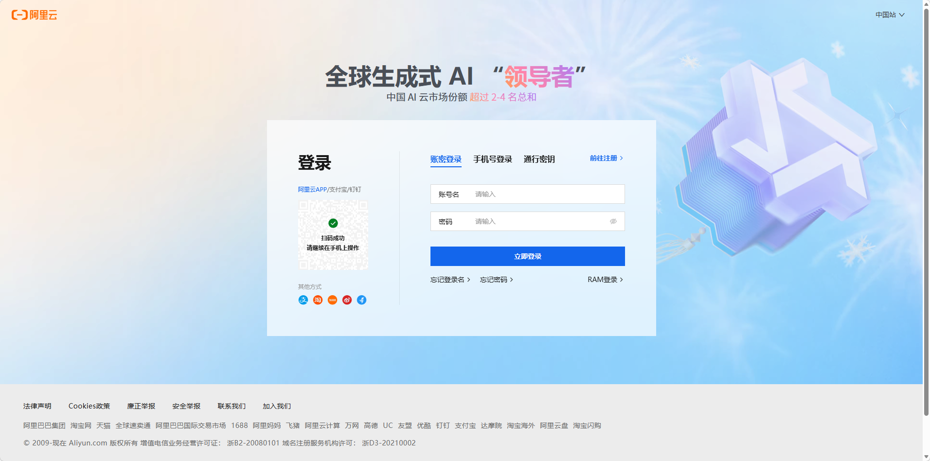

1.1 登录阿里云
访问阿里云官网:阿里云-计算,为了无法计算的价值
使用以下任一方式登录:
- 阿里云账号
- 支付宝
- 钉钉

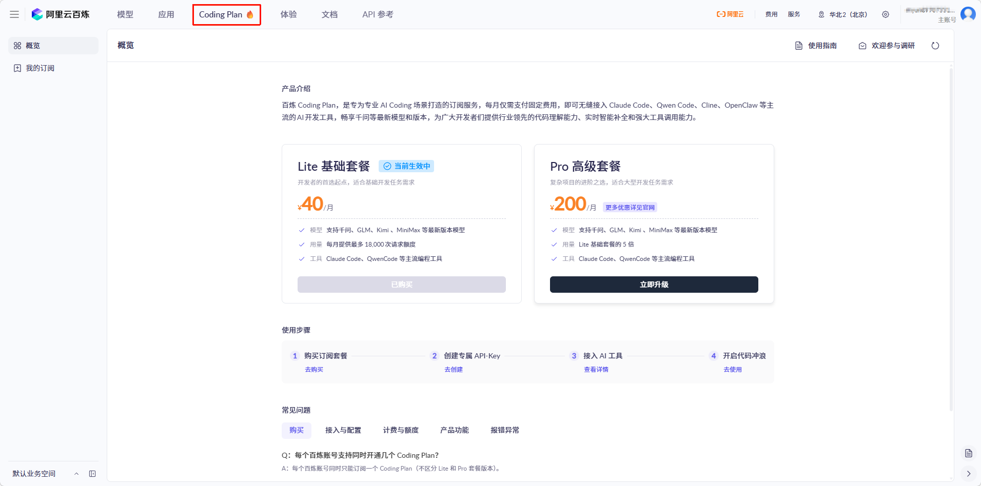

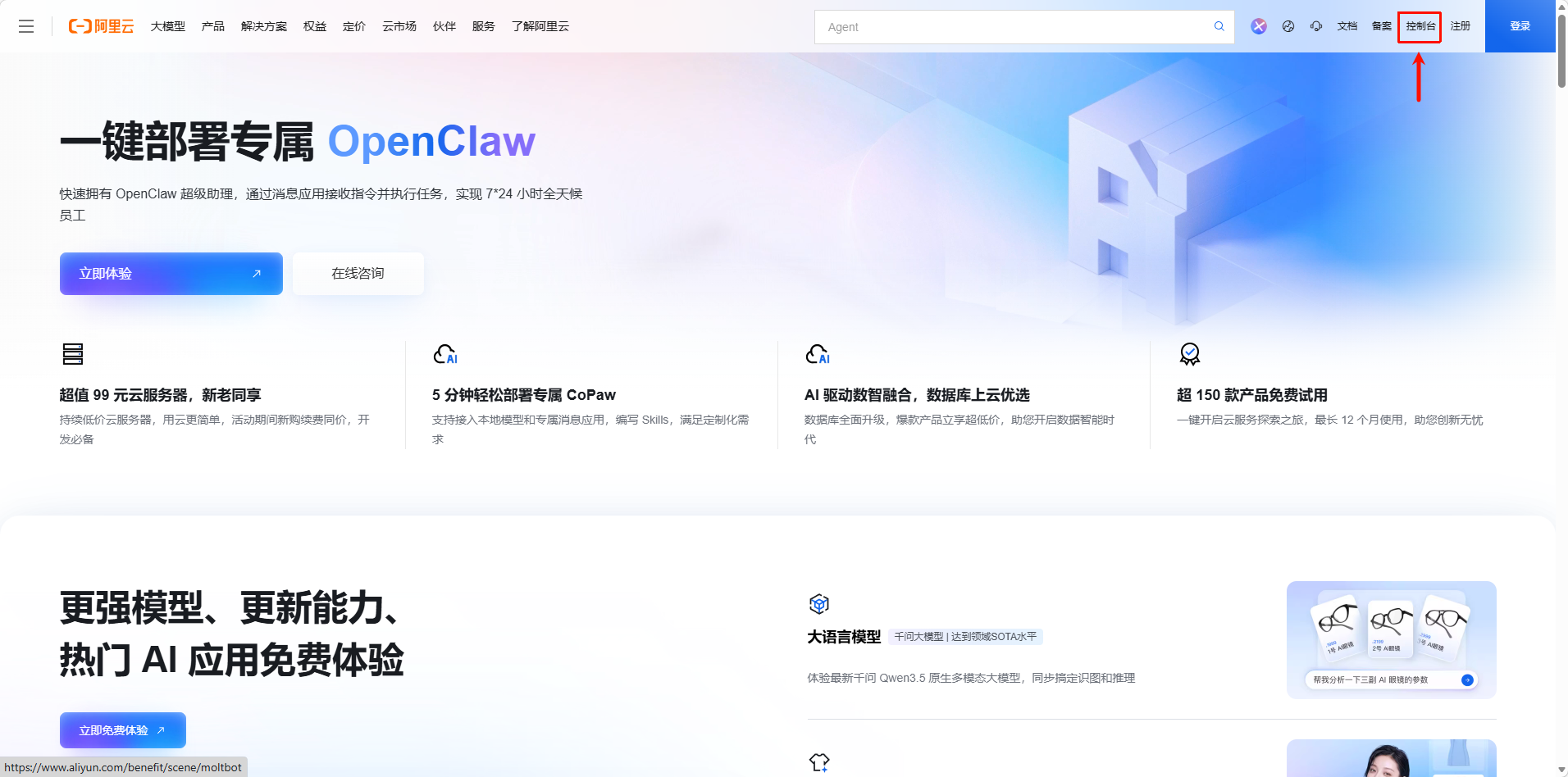

1.2 购买Coding Plan
进入阿里百炼控制台,购买Coding Plan:
访问地址:大模型服务平台百炼控制台

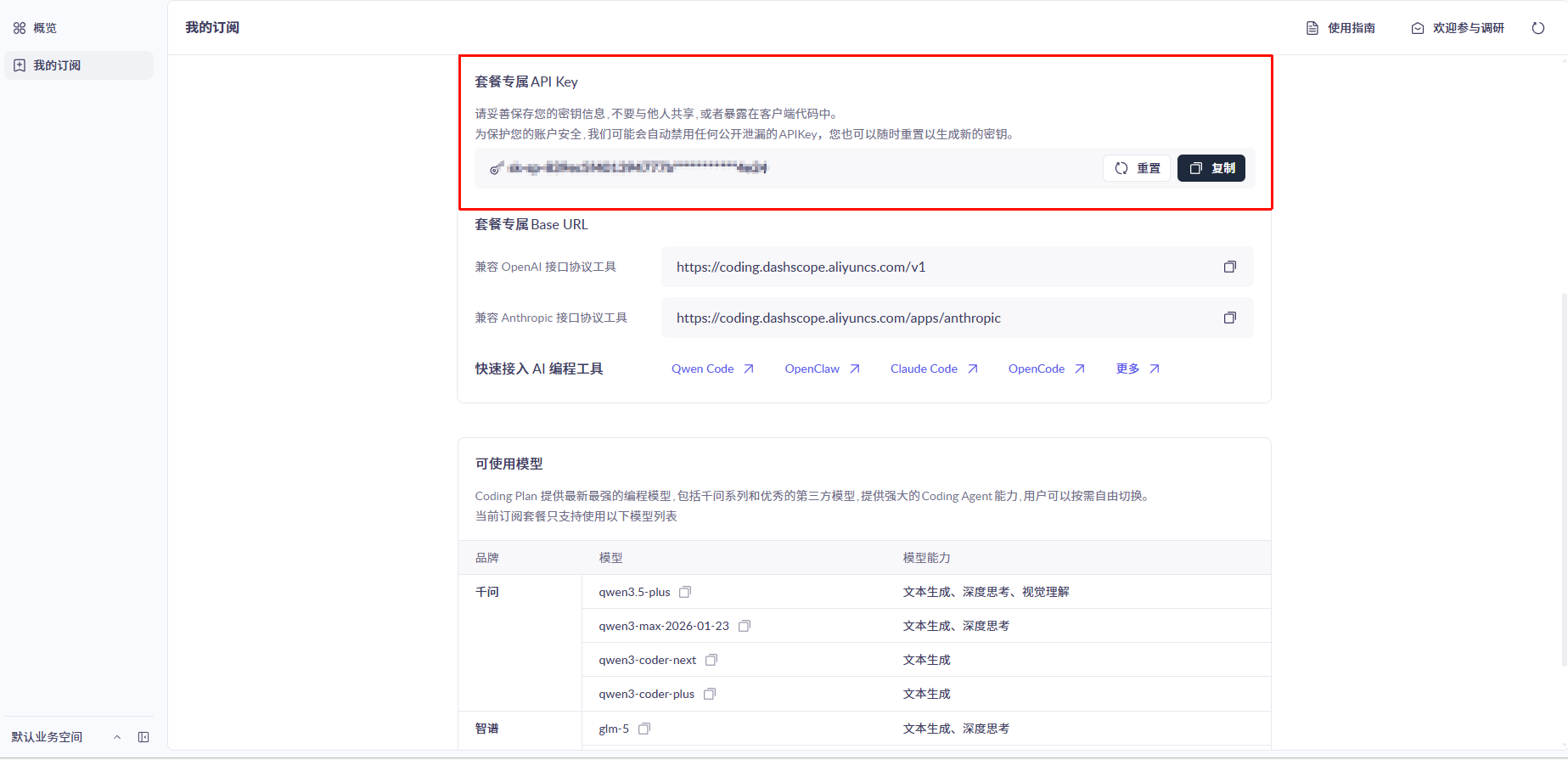

1.3 获取API Key
复制并保存你的API Key,后续配置需要使用。

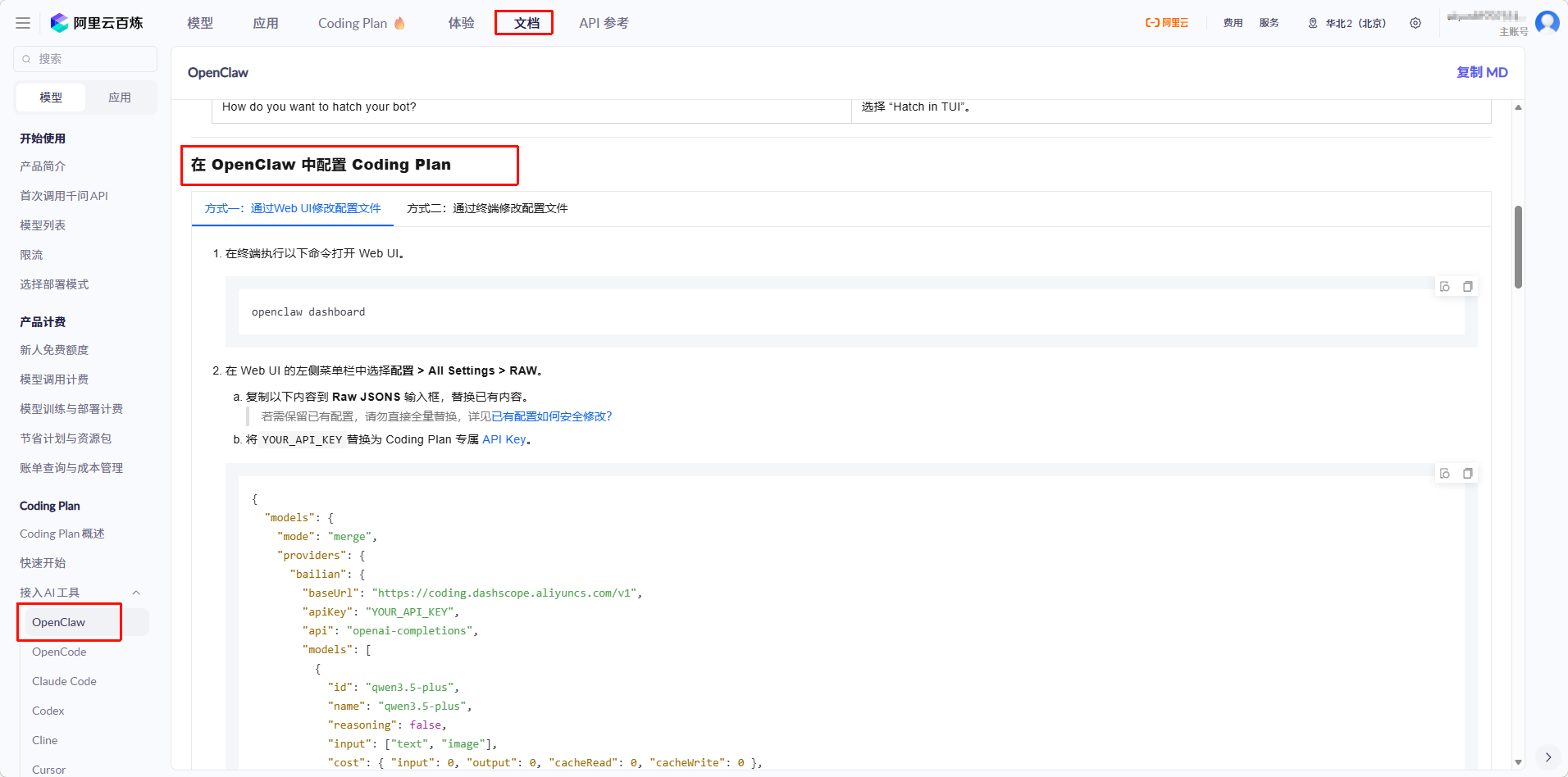

1.4 参考文档
参考阿里云百炼平台文档接入OpenClaw:
二、访问OpenClaw界面
- 本地配置
- 远程配置

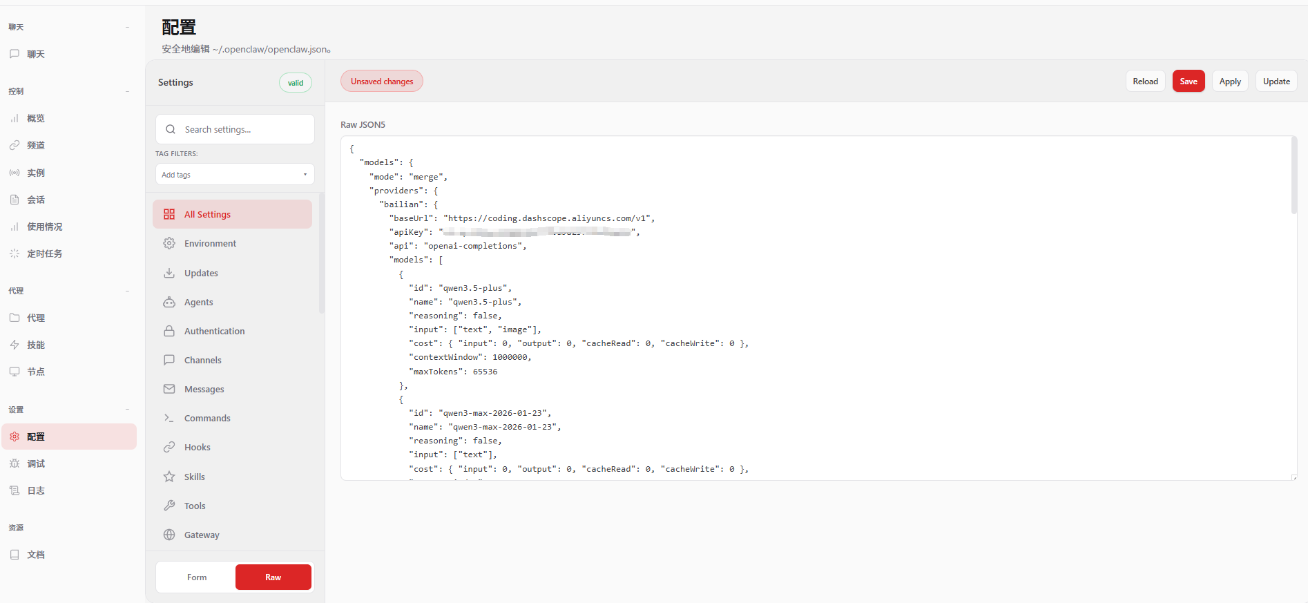

四、配置openclaw.json

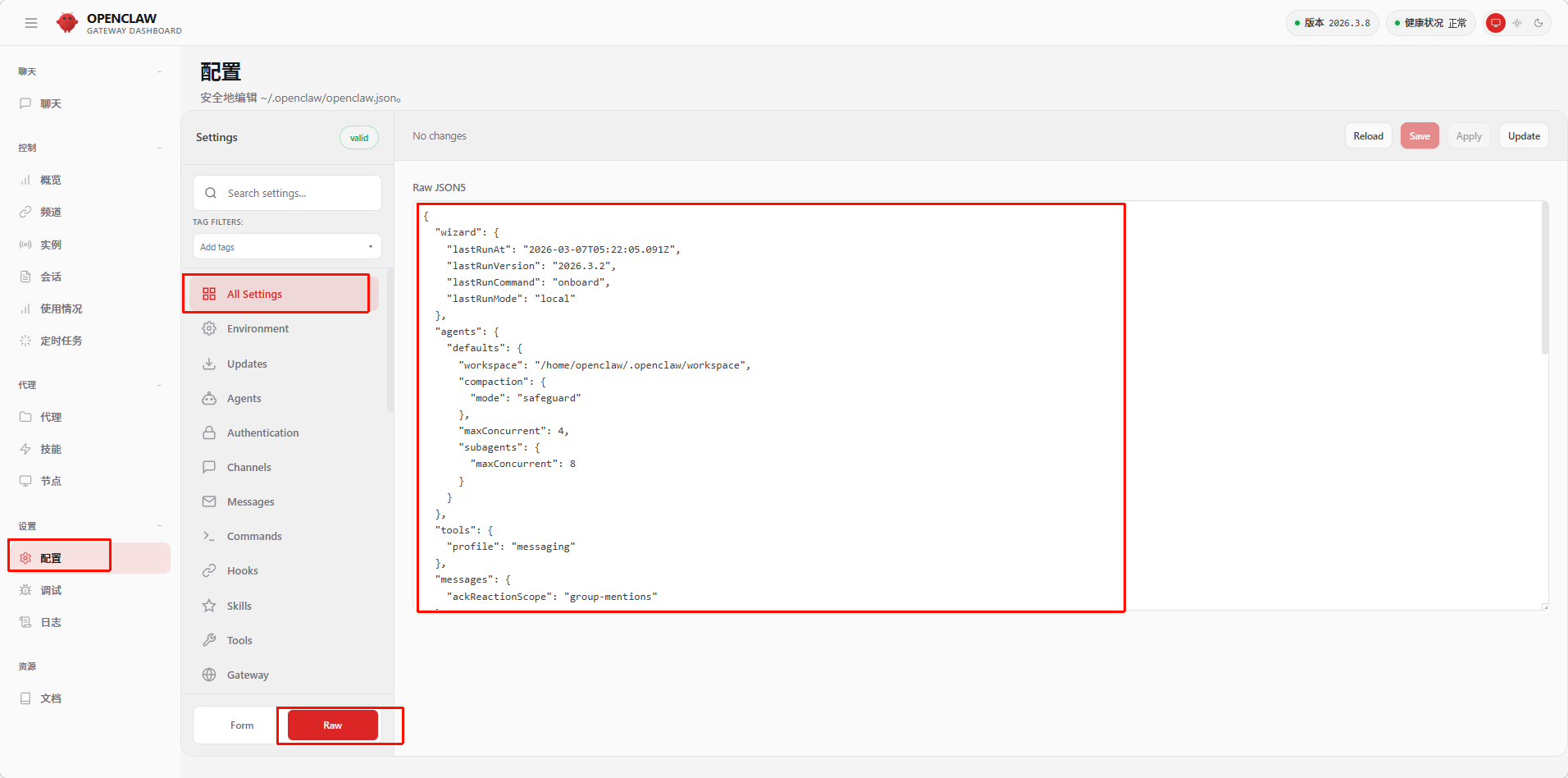

参考阿里云百炼文档,在Web UI的左侧菜单栏中选择 配置 > All Settings > RAW。
4.1 配置步骤
- 复制以下内容到 Raw JSONS 输入框,替换已有内容
- 将
YOUR_API_KEY替换为Coding Plan专属API Key - 单击右上角 Save 保存,然后单击 Update 使配置生效
"models": {
"mode": "merge",
"providers": {
"bailian": {
"baseUrl": "https://coding.dashscope.aliyuncs.com/v1",
"apiKey": "YOUR_API_KEY",
"api": "openai-completions",
"models": [
"id": "qwen3.5-plus",
"name": "qwen3.5-plus",
"reasoning": false,
"input": ["text", "image"],
"cost": { "input": 0, "output": 0, "cacheRead": 0, "cacheWrite": 0 },
"contextWindow": 1000000,
"maxTokens": 65536
"id": "qwen3-max-2026-01-23",
"name": "qwen3-max-2026-01-23",
"reasoning": false,
"input": ["text"],
"contextWindow": 262144,
"maxTokens": 65536
"id": "qwen3-coder-next",
"name": "qwen3-coder-next",
"reasoning": false,
"input": ["text"],
"maxTokens": 65536
"id": "qwen3-coder-plus",
"name": "qwen3-coder-plus",
"reasoning": false,
"input": ["text"],
"maxTokens": 65536
"id": "MiniMax-M2.5",
"name": "MiniMax-M2.5",
"reasoning": false,
"input": ["text"],
"contextWindow": 196608,
"maxTokens": 32768
"id": "glm-5",
"name": "glm-5",
"reasoning": false,
"input": ["text"],
"contextWindow": 202752,
"maxTokens": 16384
"id": "glm-4.7",
"name": "glm-4.7",
"reasoning": false,
"input": ["text"],
"maxTokens": 16384
"id": "kimi-k2.5",
"name": "kimi-k2.5",
"reasoning": false,
"maxTokens": 32768
"agents": {
"defaults": {
"model": {
"primary": "bailian/qwen3.5-plus"
"models": {
"bailian/qwen3.5-plus": {},
"bailian/qwen3-max-2026-01-23": {},
"bailian/qwen3-coder-next": {},
"bailian/qwen3-coder-plus": {},
"bailian/MiniMax-M2.5": {},
"bailian/glm-5": {},
"bailian/glm-4.7": {},
"bailian/kimi-k2.5": {}
"gateway": {
"mode": "local"
填入位置如下:
最终配置如下:

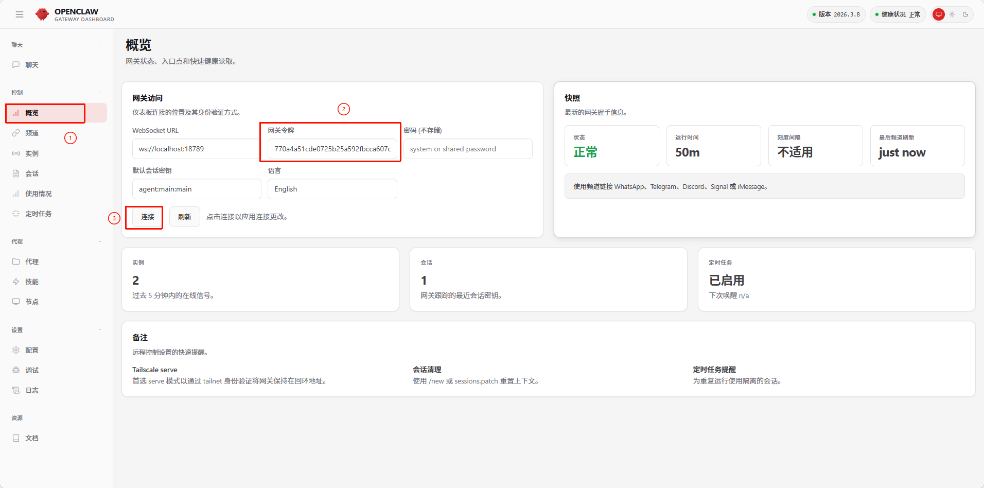

五、重新配置网关令牌
- 本地配置
- 远程配置
无需配置
本地浏览器访问无需重新配置网关令牌,直接刷新页面即可。
Reload之后,网关令牌会重新刷新,Windows浏览器会再次提示:
unauthorized: gateway token missing (open the dashboard URL and paste the token in Control UI settings)
需要在 "概览" → "网关令牌" → "连接" 重新填入新的网关令牌。

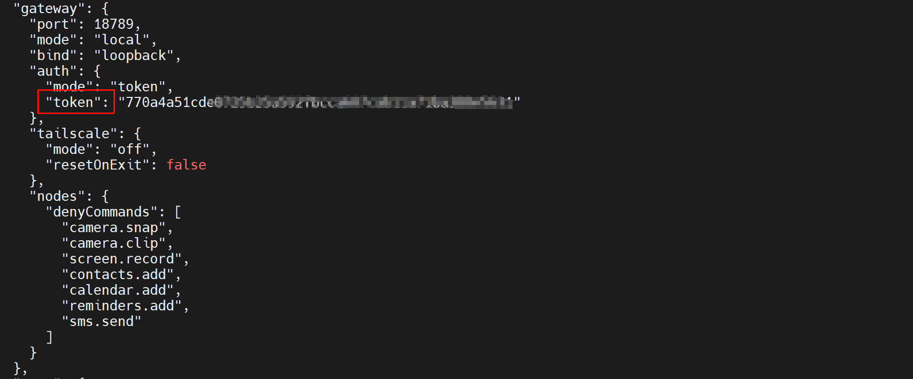

网关令牌同样在 ~/.openclaw/openclaw.json 中查看。

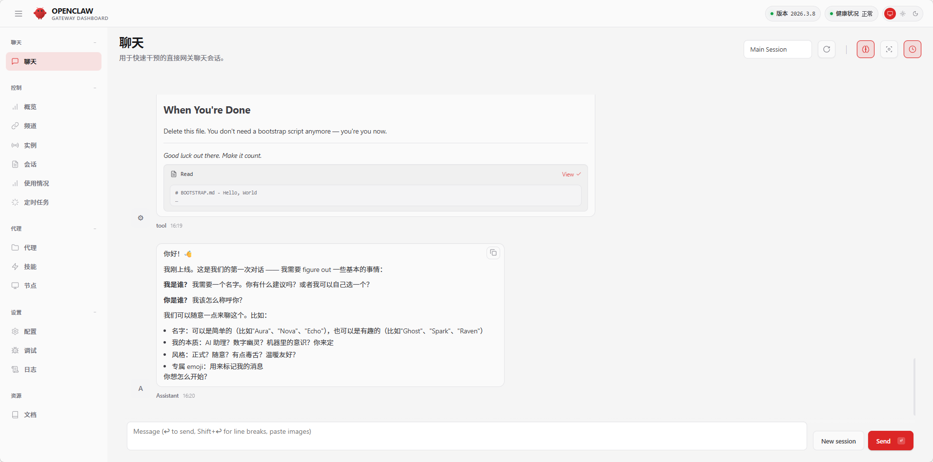

六、验证配置
最后,右上角健康情况显示正常,你就可以在聊天框与OpenClaw开始聊天了!

Q: 网关令牌忘记了怎么办?
A: 重新执行 cat ~/.openclaw/openclaw.json 查看。
