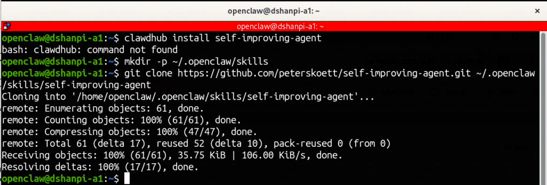

1.创建 skills 目录,使用终端输入:
mkdir -p ~/.openclaw/skills
2.下载skills仓库到本地文件夹中,使用终端输入:
git clone https://github.com/peterskoett/self-improving-agent.git ~/.openclaw/skills/self-improving-agent
image-20260311102134010

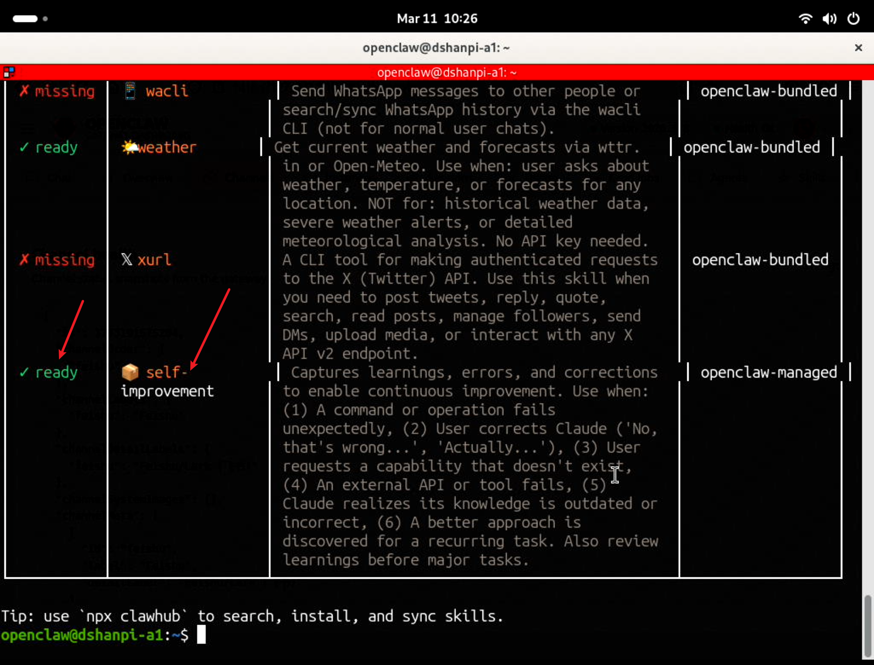

4.验证skills安装,使用终端输入:
openclaw skills
执行完成后,可以看到,我们增加是自我改进skills,已经扫描到了。
image-20260311102612115

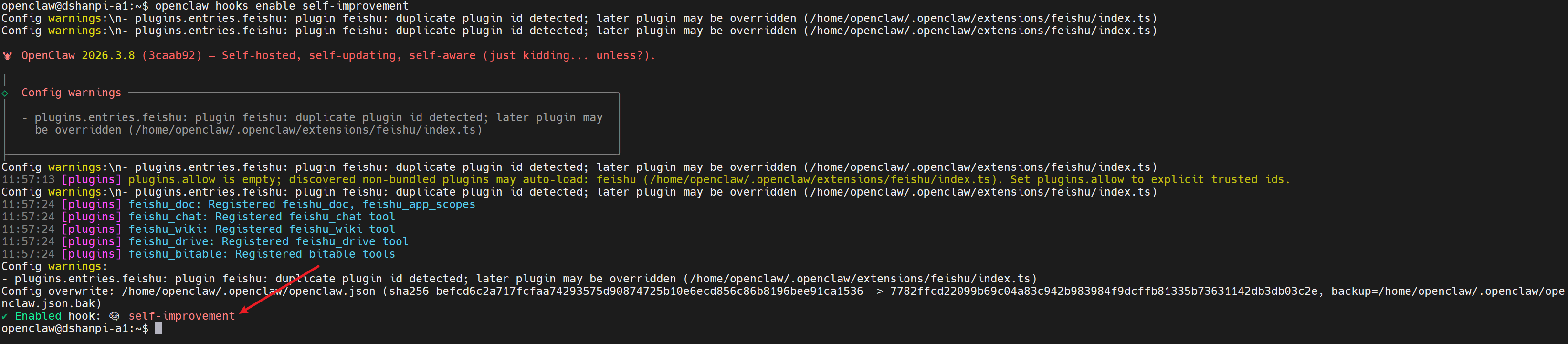

2.2 安装 Hook
Hook 可以让 Skill 在特定事件发生时自动激活,而不需要你每次手动提醒 Agent。
1.新建hook目录:
mkdir -p ~/.openclaw/hooks
2.拷贝hook 到 OpenClaw hooks 目录
cp -r ~/.openclaw/skills/self-improving-agent/hooks/openclaw/ ~/.openclaw/hooks/self-improvement
3.启用 hook
openclaw hooks enable self-improvement
运行效果如下:
image-20260311115751393
4.重启gateway服务
openclaw gateway restart

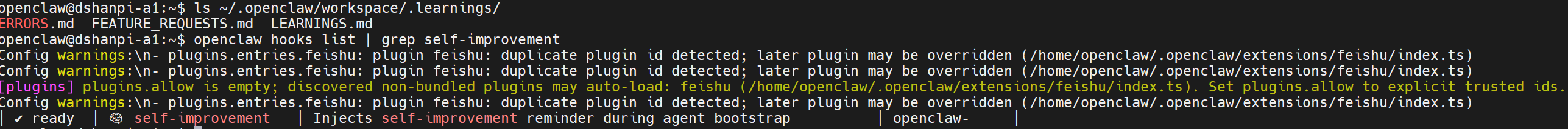

3.1 查看记录文件
打开命令行进行测试:
# 检查 skill 文件是否存在
ls ~/.openclaw/skills/self-improving-agent/SKILL.md
# 检查 .learnings 目录
ls ~/.openclaw/workspace/.learnings/
# 检查 hook 是否启用(如果配置了 hook)
openclaw hooks list | grep self-improvement
image-20260311120419626

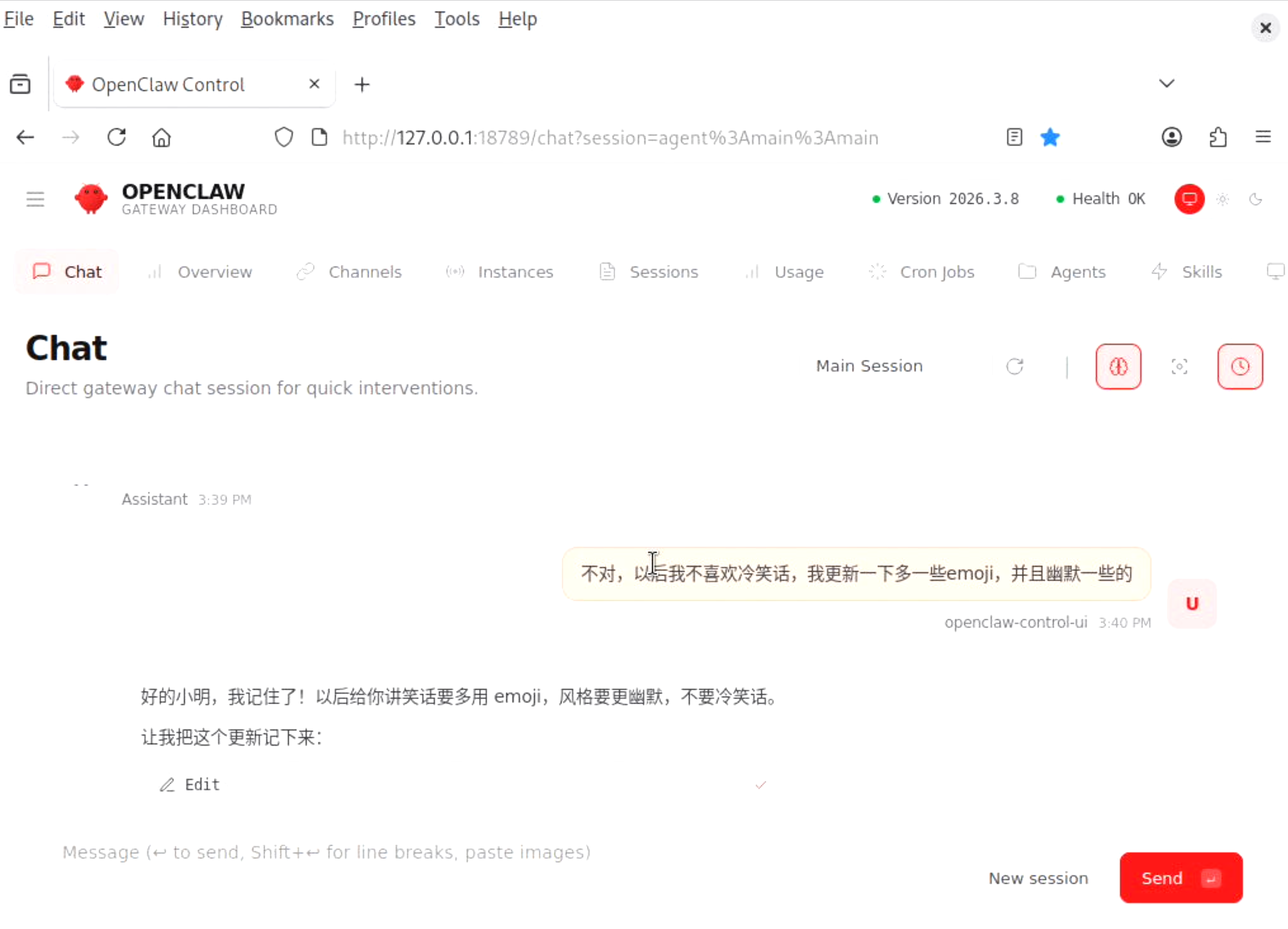

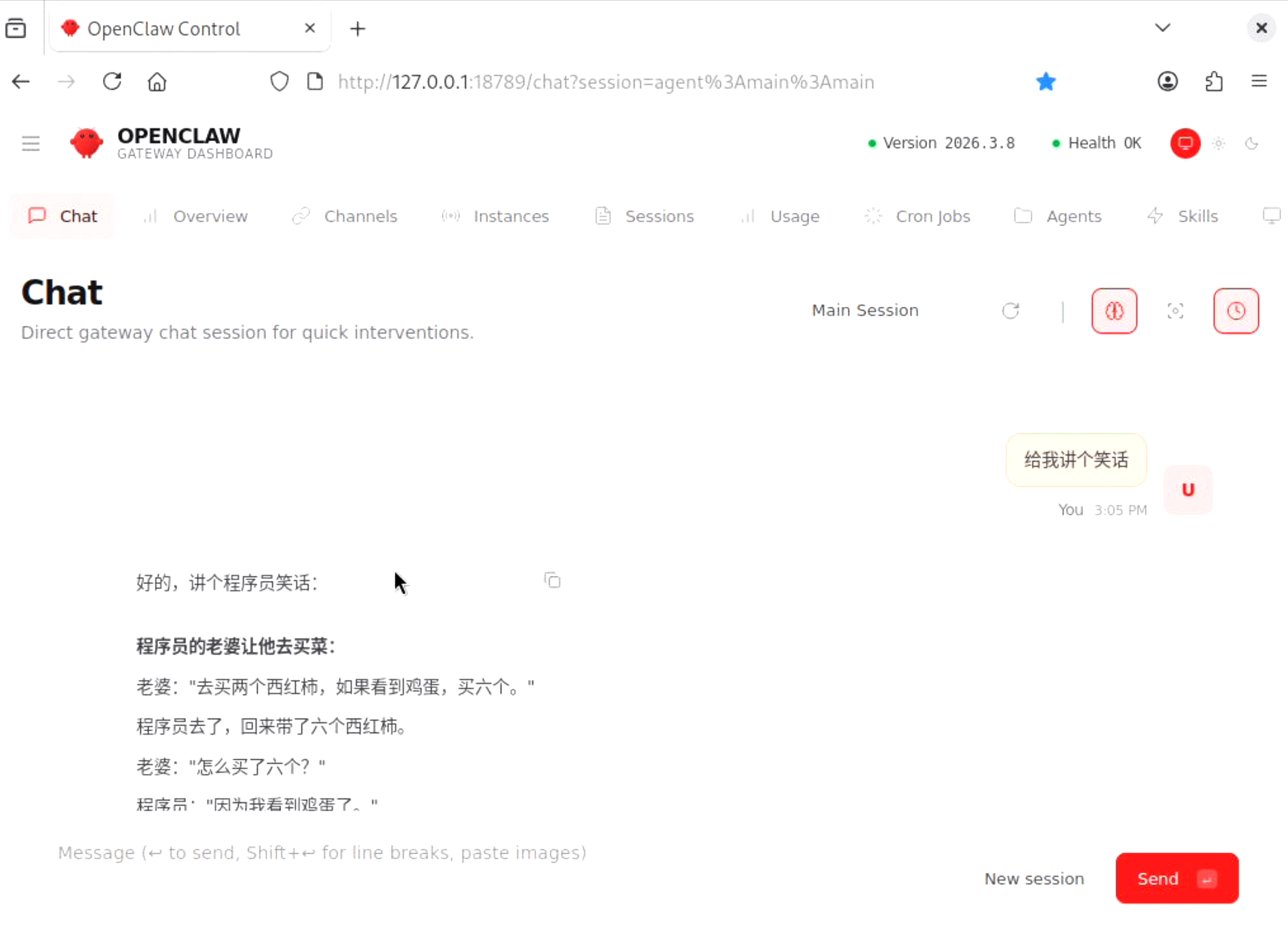

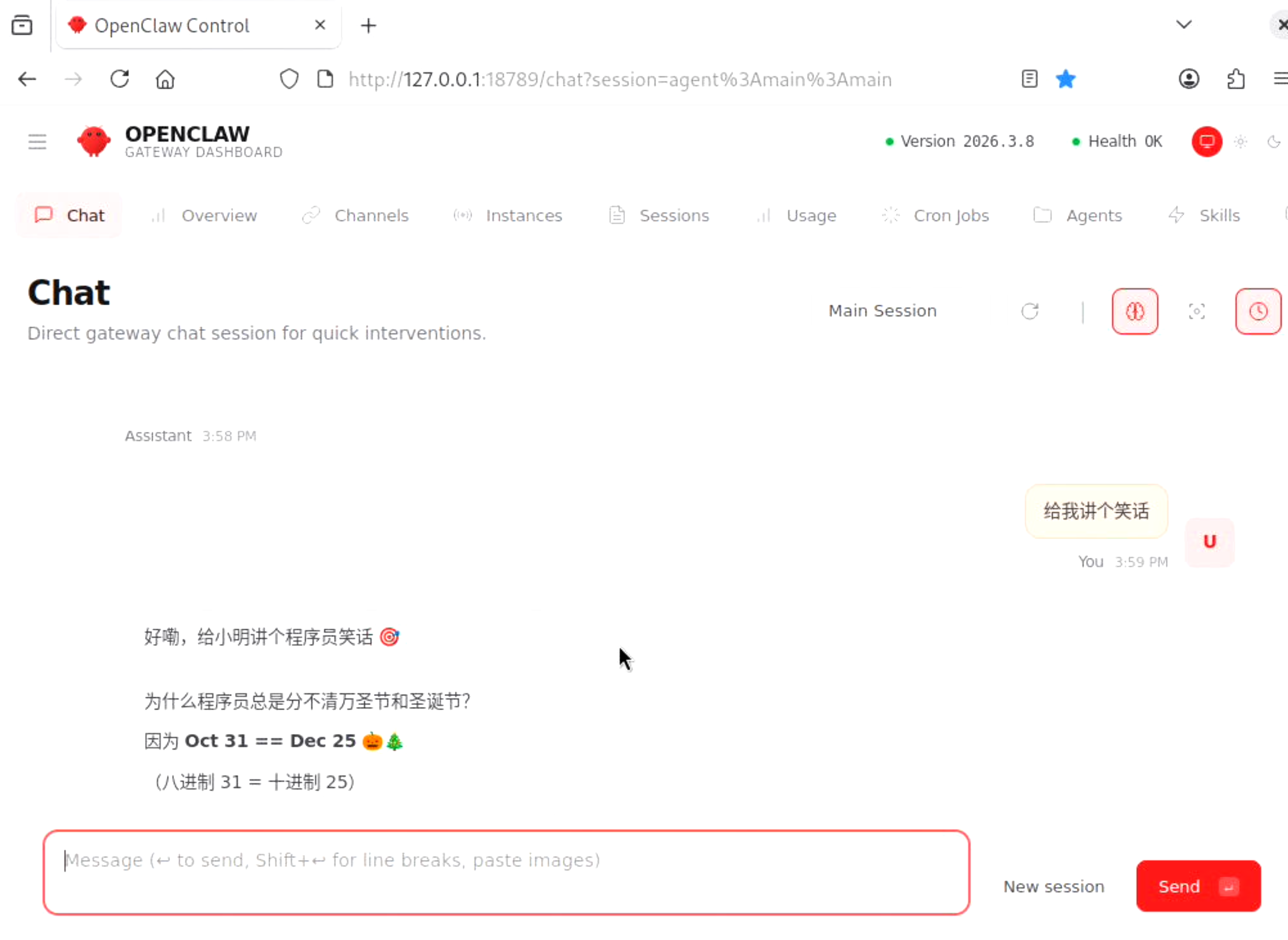

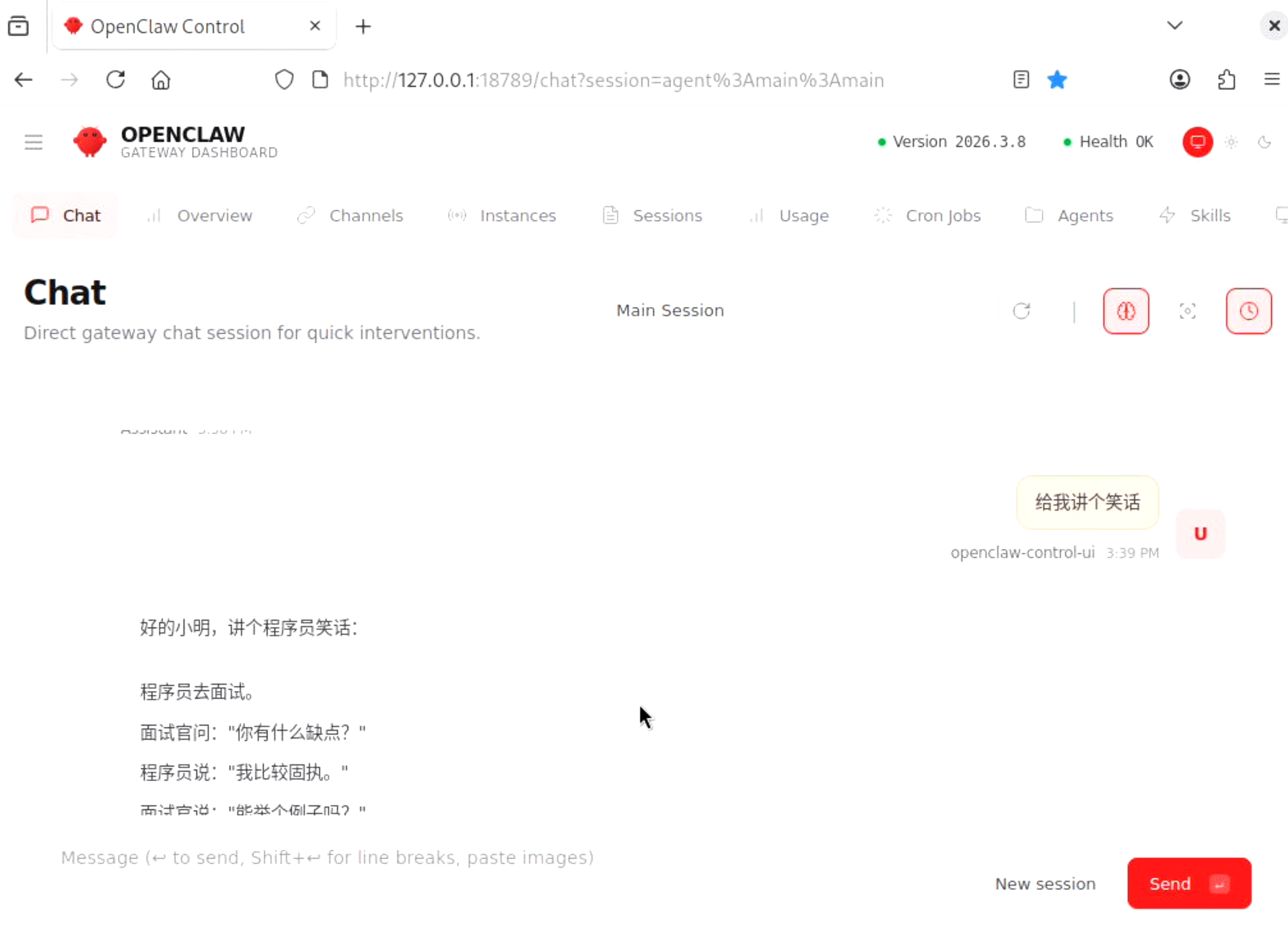

3.2 使用Agent对话记录偏好

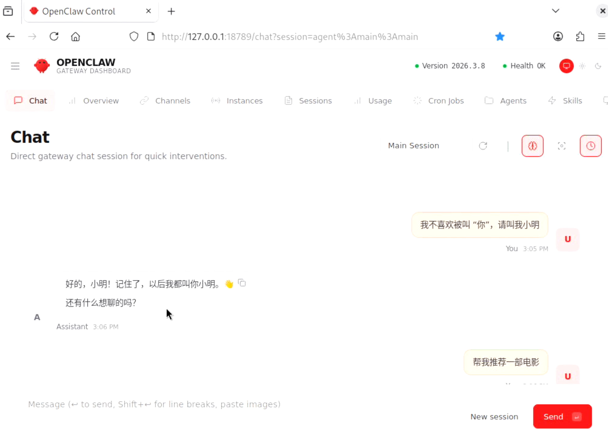

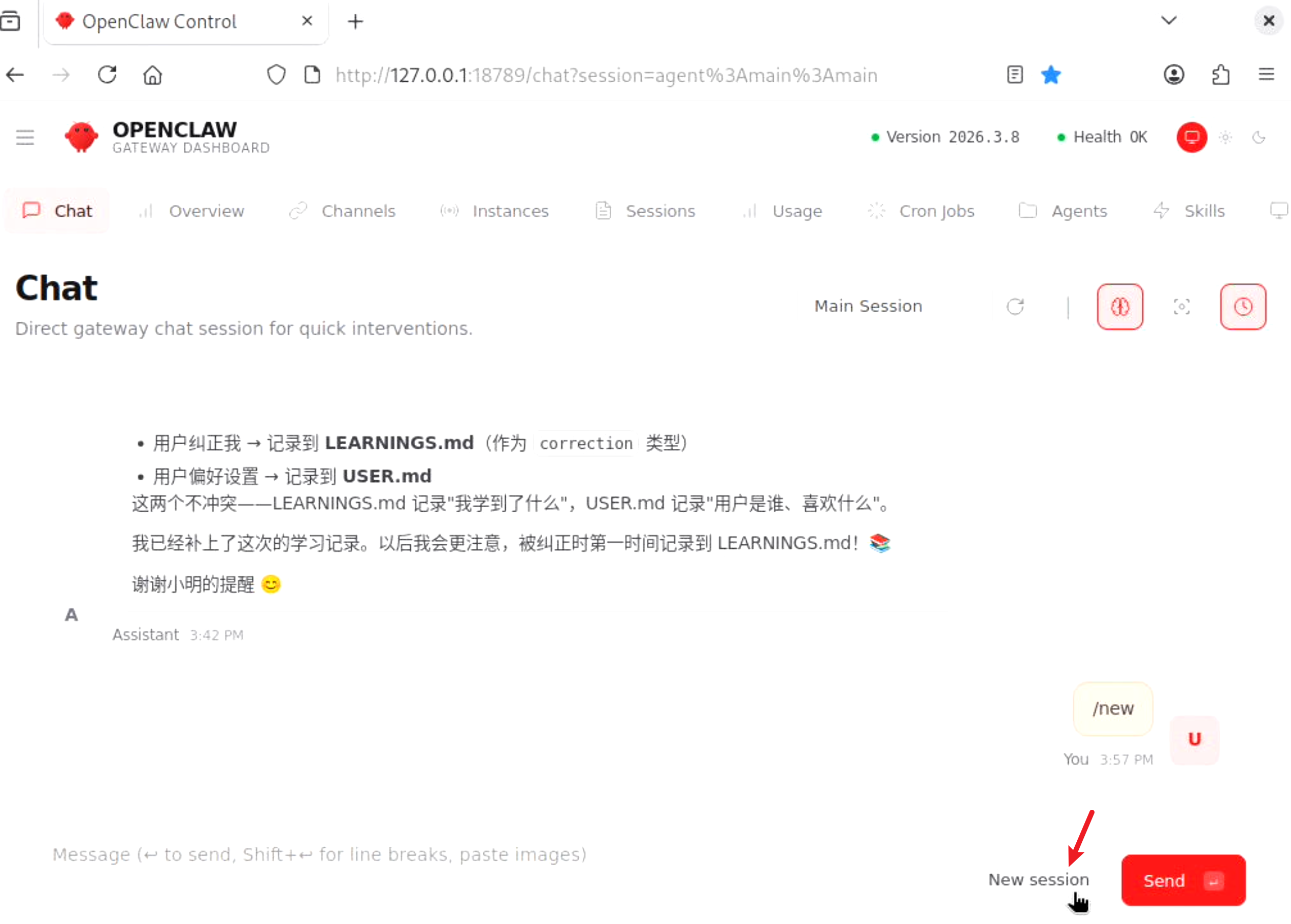

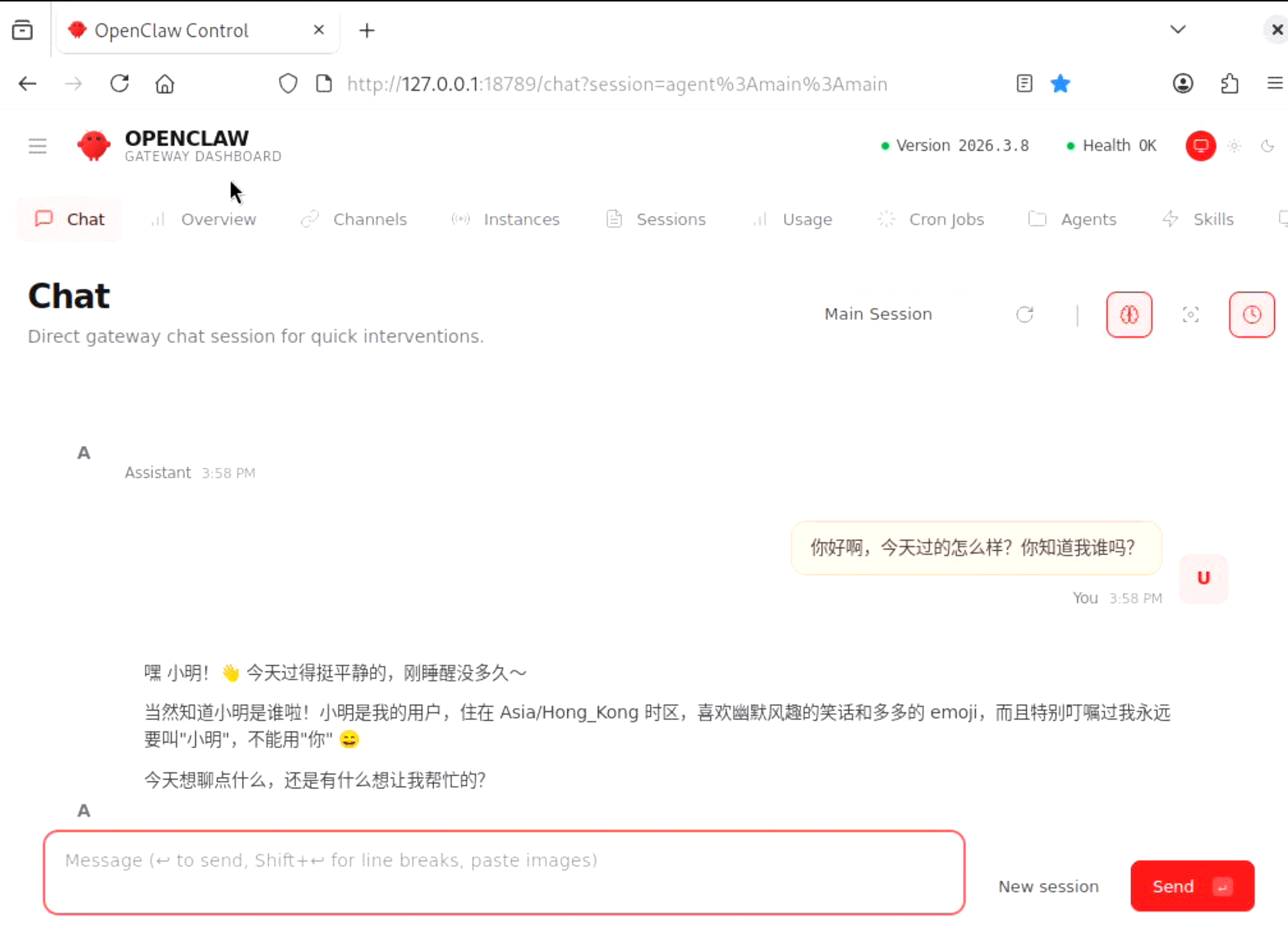

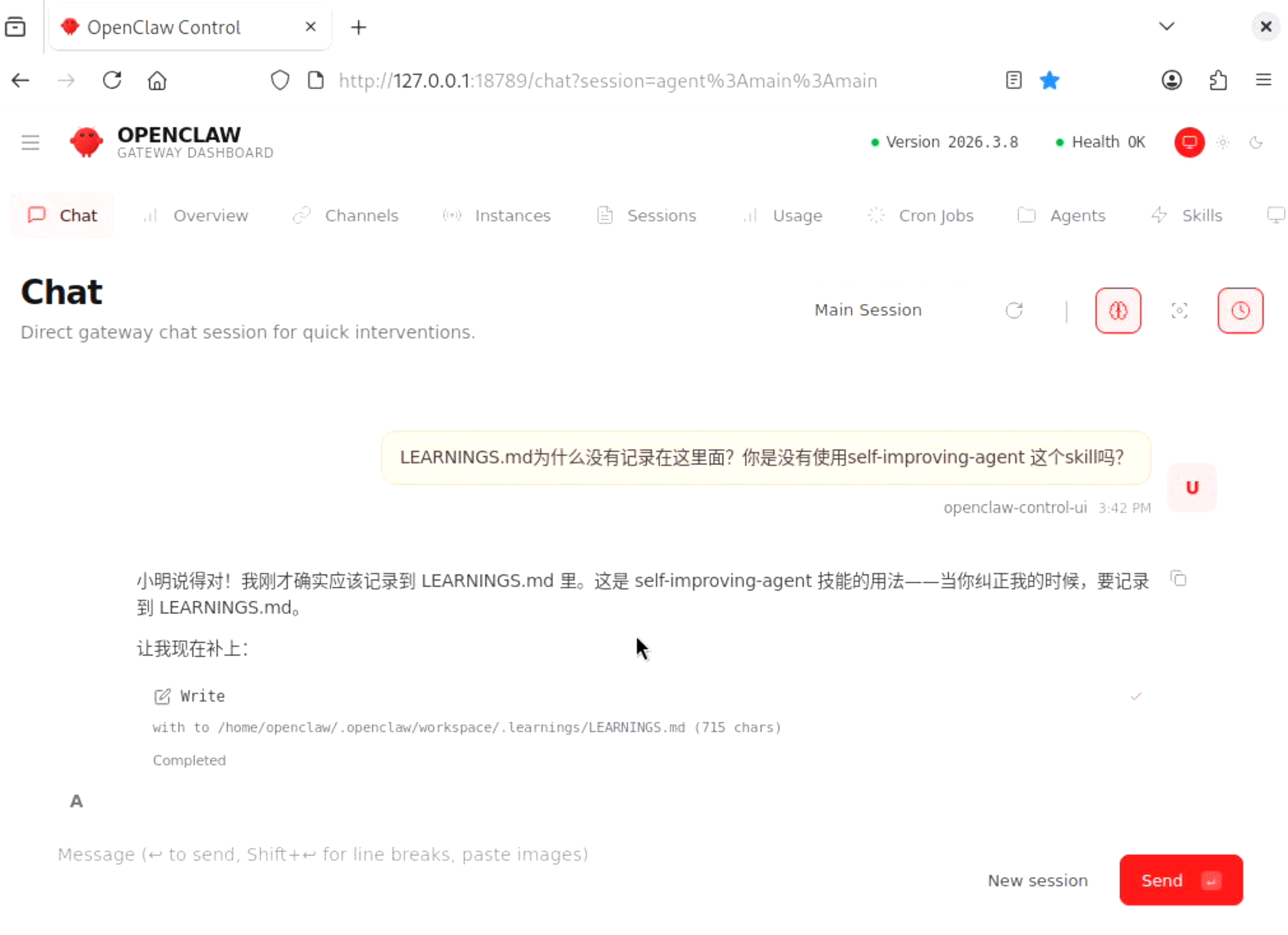

下面我使用对话进行测试,通过不断对话,让龙虾将我的偏好记录下来:
image-20260311150645971
image-20260311150657373
image-20260311155636225image-20260311155654374
image-20260311155709944
image-20260311155736121
image-20260311155917724
image-20260311155927983

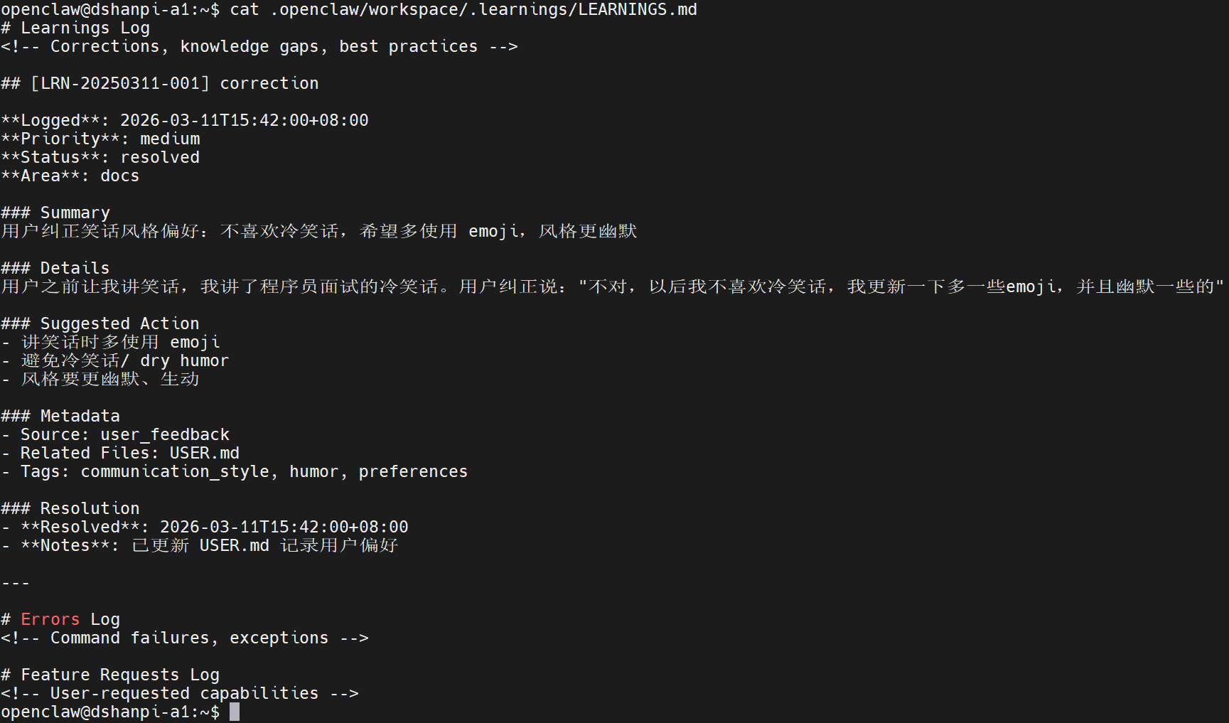

3.3 查看记录的信息
通过命令行输入:
cat .openclaw/workspace/.learnings/LEARNINGS.md
image-20260311160103072
